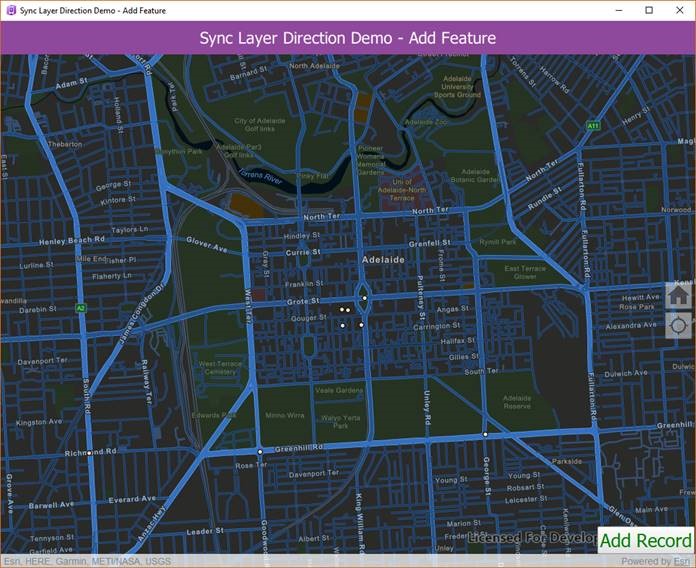

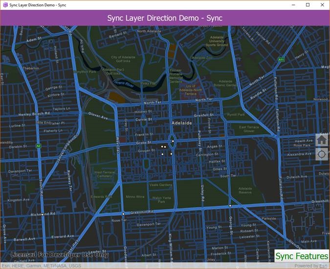

I have create a pair of apps that demonstrate this case, please find the download link here. Please unzip the file, then you will find the following:
  • Application 1: syncLayerDemo-add:
    • An application that has one layer added to the MapView control, “activity” layer, which is a hosted feature service layer on AGOL.
    • The “Add Record” buttons creates a new feature in a random location around the map center and add it directly to the layer
  • Application 2: syncLayerDemo-sync
    • This application creates a local geodatabase file replica from the same hosted feature service used by “Application 1”, and add the “activity” layer to the MapView
    • The “Sync Features” buttons starts the sync operation, and the “activity” layer gets refreshed to show the newly added features

  • On “Application 1”
    • Press on “Add Record” button
    • A new point feature is added to the map
  • On “Application 2”
    • Press on the “Sync Features” button
    • Wait for the sync operation to finish
Expected: the sync operation pushes local changes from device to AGOL hosted feature service, and not to download any changes from AGOL hosted feature service to local device
Actual: the sync is pushing local changes and also downloading changes from AGOL.
