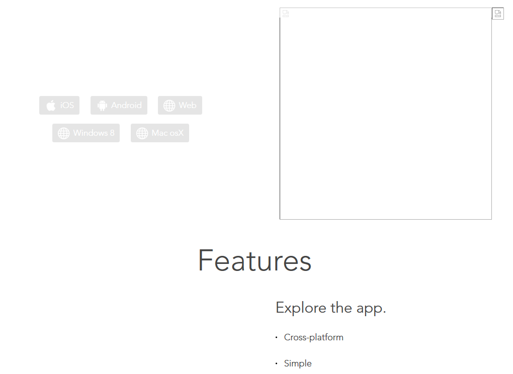

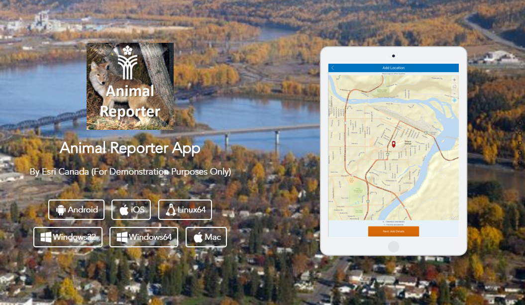

Using the web version of AppStudio for ArcGIS, I have created and configured a Landing Page...  When I am signed in, I am able to edit, save, and view the Landing Page correctly:
However, when trying to access this page without singing in (aka, anyone public trying to access the site), I get the following result:
I have tried a different combination of images, and get the same result...  I have also tried the hosted version of this (http://appstudio.arcgis.com/landingpage/ea1f272052164c9f8f2a1f7e70c4133b/) and have downloaded it to a local server (http://arcgis103.esri.ca/uc2016/animal/) - same results...
Any advice on how to proceed would be greatly appreciated...  Thanks!

Hi Hannah...
As noted above, I also downloaded the source code and hosted it on our web server:
In addition, I downloaded a second version of the landing page, but this time I accepted all of the default settings, making no alterations or changes to the wizard settings...  The results are here (same thing):
http://arcgis103.esri.ca/uc2016/animal2/
Thanks...  Mark

Hi again Hannah...  Sorry about the broken link...  We were changing some things on our end...
Here's another link to try - downloaded from the appstudio.arcgis.com landing page section:
http://arcgis103.esri.ca/test/animal
Have you tried building a landing page using the default settings from scratch on your end?  You should be getting the same results we are...  We have tried this many times...
Let me know if you need anything else...  Thanks...  Mark

by Anonymous User
Not applicable
Hi again Hannah...  Thanks for poking the stick...  I just added the landing page to a later version of IIS on an Amazon server...  And voila!  It just works...  Never trust an older IIS, I suppose...
http://52.71.218.2/demos/pganimalreporter/
Thanks for the inspiration to get this to go!  Problem solved...
