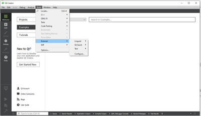

najeebhall
I have this same issue except when i open qt creator i do not see appstudio under the external option ( see attached photo).  Franklin above stated ' I had to manually add AppStudio to the external tools.' Could you please explain how this is done?
