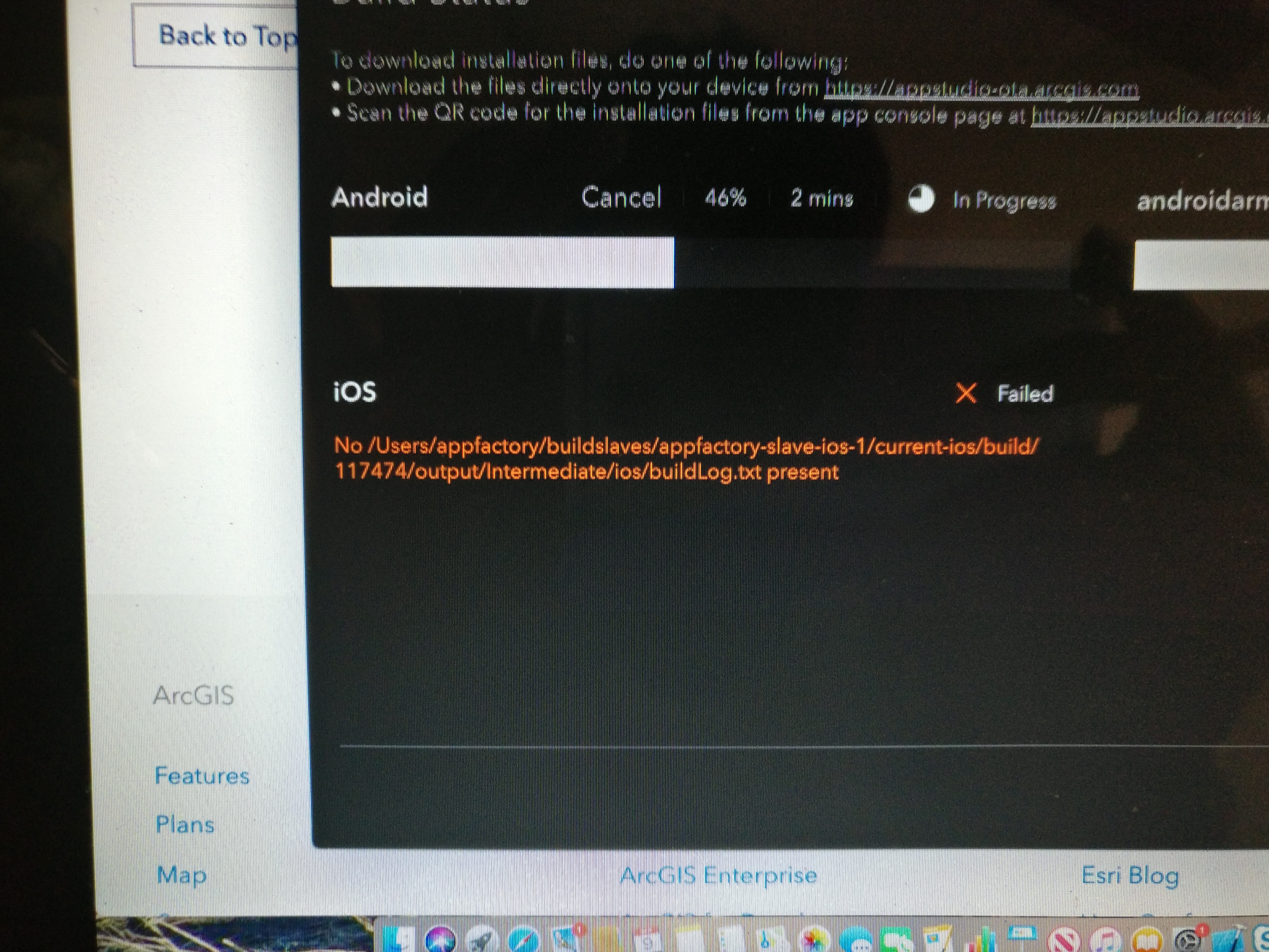

Hi App Studio For ArcGIS Team ,
I am developing an App Studio Enterprise App using Survey 123 Template (version 3.5) on latest app studio version(4.0) on macbook (10.14.5) with developer licence for app studio .
we seem to getting an error while generating ios device cloud build using app studio.This bug is coming every time ,earlier it was working fine with earlier app studio versions.Android Build generation seems to work fine.
I wanted to find if any help can be provided for same.
As per my understanding ,we are using app store provisioning profile and certificate ,but certificate password has some special characters, so is it possible that cloud build is not able to parse .p12 with special characters in it.
Any quick help or any workaround ,please suggest.
Regards,
Sumit
No /Users/appfactory/buildslaves/appfactory-salve-ios-1/current-ios-build/117474/output/intermediate/ios/buildLog.txt present
Bug while generating ios cloud build

Hi Sumit,
I checked the build logs for your app on the AppStudio Cloud Make build server. There is no problem with the p12 file and the password supplied. Build failed because a valid provisioning profile was not included with the build request.
Can you please ensure that the provisioning profile is correctly selected in AppStudio Settings -> Platforms -> iOS -> Provisioning Profile. And, submit the build request again?
