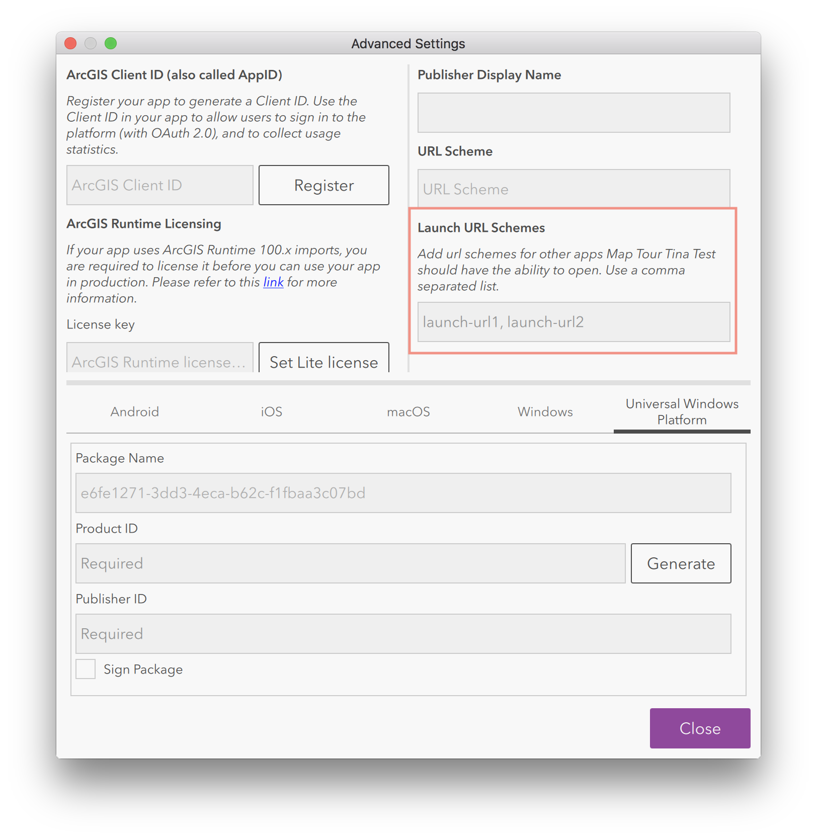

URL Schemes let you launch other apps from your app and as of iOS 9, the URL Schemes need to be whitelisted. We have added UI in the Advanced Settings dialog to allow you to specify launch URL Schemes.
While adding support for the high accuracy GPS receiver, we also introduced a new field in the Advanced Settings dialog for specifying External Accessory Protocol Strings. This is needed for iOS apps, to provide a list of third-part external accessories that have whitelisted your app.

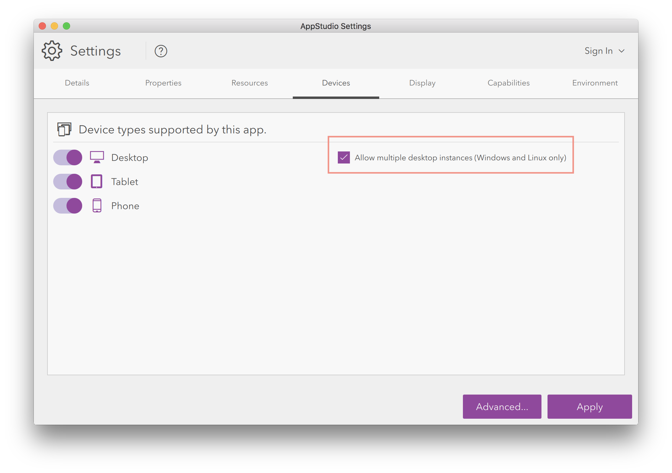

The Settings tool now provides the option to enable or disable multiple instances for Windows and Linux apps.
