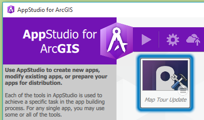

If you have made many map tour apps - we have created a sample that can help you repair your existing apps.To download the sample,
  • Open AppStudio for ArcGIS (Desktop Edition)
  • Browse to Search > Groups > Sample Apps
  • Download the Map Tour Update sample
This sample will.
  • find all apps in your ~\ArcGIS\AppStudio\Apps folder, of the type map tour and in each of them,
  • remove the import ArcGIS.AppFramework.Runtime.Dialogs 1.0 from the top of the file MapTour/MapTourApp.qml, and
  • copy the file MapTour/PortSignInDialog.qml to your existing map tours MapTour folder
You could also do these steps manually without running the sample. Be sure to create a new map tour with version 1.0 of AppStudio to get a copy of the MapTour/PortSignInDialog.qml file to copy into your old app.
