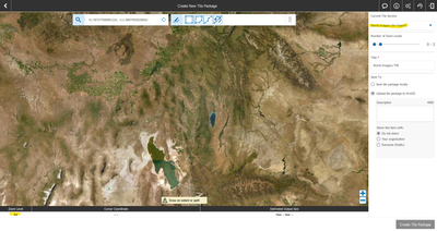

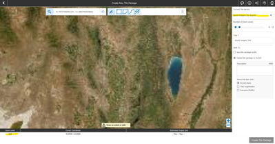

I'm fairly new in the ESRI/ARCGIS community. I'm trying to use the Tile Package Kreator app version 1.4.1 to export some World Imagery (for export) tiles. For some reason, the resolution of the World Imagery wont go past level 8 on the zoom. It's just a digital zoom of the resolution of level 8.

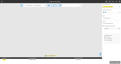

Then once I get to level 12, the image is unavailable.
Am I doing something wrong or is this an issue that needs to be addressed by ESRI?
