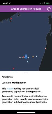

A popup is a pane that displays an identified features’ field attributes. In ArcGIS Online, you can configure popups using Arcade expressions to display customized text with styling. The text can be derived directly from field values or can use logic and calculations to display custom strings. You can follow this ArcGIS Learn Lesson that demonstrates how to do this. Once this popup is configured, AppStudio can pull that web map containing the layer with the configured popup as HTML text which can then be displayed in a pane on your mobile app. The example below demonstrates an AppStudio app that displays a configured popup from the above mentioned learn lesson.
