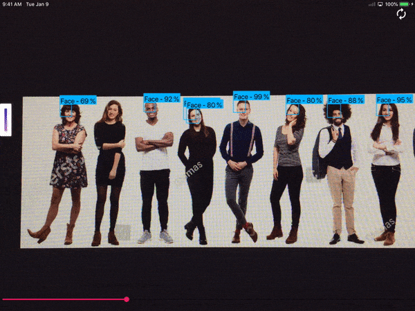

Here is the demo of how the app looks like,
(view in My Videos)
Please refer to the sample "Deep Learning" in AppStudio Desktop and Player to see how it works and please refer to this documentation on how to train a TensorFlow model using ArcGIS API for Python using ArcGIS Notebook.
