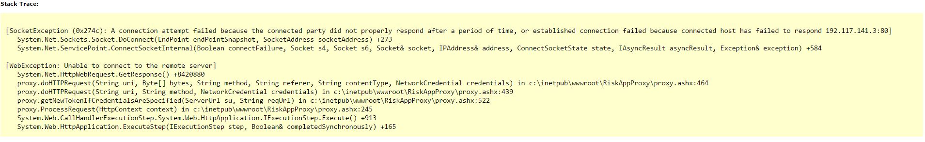

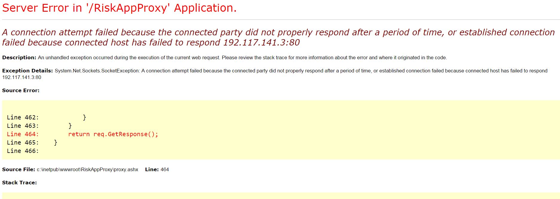

it seems that i have a similar problem but i did set the credentials in the proxy.config file.
roialgavish
The problem was resolved.
I needed to go to the service with the .local and not with .co.il
like this:
PathToProxy.co.il?PathToServiec.local
