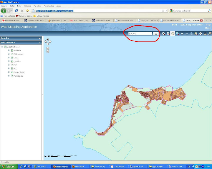

Hi, where i work we have this application (on the screenshot):
The marked area is a zoom by scale function, where you type the scale and it zooms in till the map reaches the desired scale.

The Silverlight map uses resolution in stead of scale, since scale is a very misleading value on a computer screen (because you basically don't know the dimension of your screen).
So to zoom to a scale this use the Map.ZoomToResolution(mapUnitsPerPixel) method instead.
where mapUnitsPerPixels is how many meters/feets/degrees (based on what projection you use) one pixel covers.
To convert this value from a scale, you will need to know how big a pixel is on your screen. As mentioned above this is where it gets misleading, because most screens are different (when you connect a projector you even have two scales, one on your laptop and another one on your projector). An often used assumption is 96dpi (pixels per inch), so with a little math, you can calculate the resolution based on a specific scale (ie. 1:25000 means 1inch on screen = 25000 inches on the map, so at 96 dpi, 1 pixel is 25000/96, and lastly you should convert the inches to whatever unit your map projection is using) .
