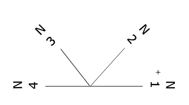

I want create a TextSymbol with vertical alignment how i can do that?
also, i want rotate this symbol...something like this:
each end of polyline, i will add a text.

thx for help, how i can automatically rotate text by the end of the polyline, like the image above...have any sample or getting started?
