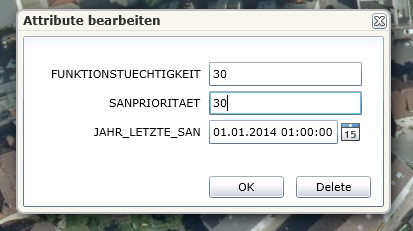

Hi,
recently I`ve taken over the development support of a larger silverlight mapping application in our company. Unfortunately there`s currently no one here who`s familiar with the application and I`ve to fix several Bugs after we migrated from ArcGIS Server 10 to 10.2.2.
One problem belongs to a FeatureDataForm
<esri:FeatureDataForm Grid.Row="1" Grid.Column="0" x:Name="myFeatureDataForm" CommitButtonContent="OK"      HorizontalAlignment="Left" ScrollViewer.VerticalScrollBarVisibility="Visible"      ScrollViewer.HorizontalScrollBarVisibility="Visible" EditEnded="myFeatureDataForm_EditEnded"
     IsReadOnly="False" LabelPosition="Left" Margin="5,5,5,5">
</esri:FeatureDataForm>
I initialize the form as follows:
FeatureLayer fl = getFeatureLayer(al.TabellenLayerID);
myFeatureDataForm.FeatureLayer = fl;
myFeatureDataForm.GraphicSource = fl.Graphics.First();
It references a table layer:
<esri:FeatureLayer ID="abschnittSanierungsbedarf" Url="/arcgis/rest/services/private/fis_deiche_event_layers_featureservice/FeatureServer/23"
ProxyUrl="../apps/fisdeiche/proxy.ashx"
DisableClientCaching="True"
AutoSave="False"
OutFields="FUNKTIONSTUECHTIGKEIT, SANPRIORITAET, JAHR_LETZTE_SAN"
Mode="OnDemand"
MaximumResolution="16"
I get back domains from the server, see the following state during debugging:
?myFeatureDataForm.FeatureLayer.LayerInfo.Fields[5].Domain
{ESRI.ArcGIS.Client.FeatureService.CodedValueDomain}
    [ESRI.ArcGIS.Client.FeatureService.CodedValueDomain]: {ESRI.ArcGIS.Client.FeatureService.CodedValueDomain}
But I don`t get drop downs with coded values in my panel.

RichardReinicke
Hi, sorry for my late answer. Yes I was able to solve it. Your layer will probably have an associated domain, please make sure your layer symbols are classified by this domain property. Then add a feature template to layer based on the domain calssification. Now if you publish the service you should have a "Types" section in your REST end point and your client problem should be solved.
