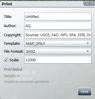

I'm trying to use the print service that is included with ArcGIS Viewer for Silverlight, version 3.1.0.110.
I have started the print service on server (ArcGIS for Server version 10.2) but when I attempt to print from the webmap, I get the message "Print failed" with no further information.

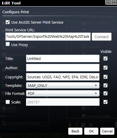

This happens whether I use the default print service url in the tool's dialog (Task: Export Web Map Task ) or the path to our own server.
The print templates appear to load successfully from either server path but when I try to print it always fails with no information about the error. Any suggestions are greatly appreciated.

To troubleshoot, you can run Fiddler when you execute print. You will see something similar to this: Under Inspectors > WebForms, You can see in the bottom TextView if there were any additional errors from the server. You can also copy the value for Web_Map_as_JSON parameter and view in a JSON Viewer Online JSON Viewer.‌ You can check the layers it's trying to print. Perhaps one of them do not meet the spec: ArcGIS REST API - Services and Data Types. Symbols used are probably not serializable. ArcGIS REST API - Services and Data Types This is quite common issue in printing and we usually try to downgrade the symbol to SimpleMarker/Line/FillSymbol whenever possible. If you need additional help, you can share the JSON with us or tell us how to repro the issue.
