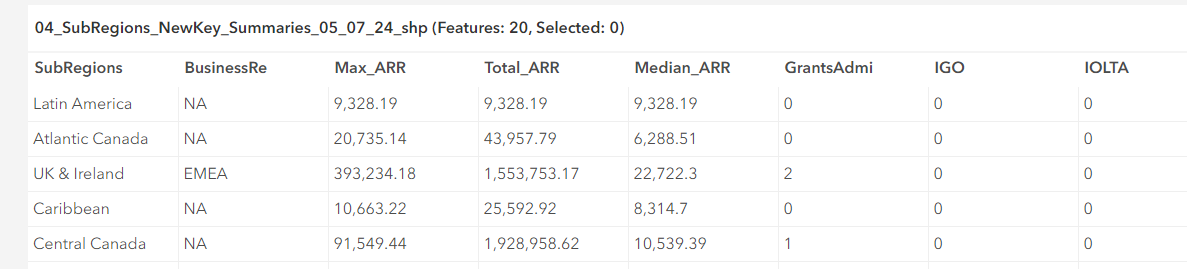

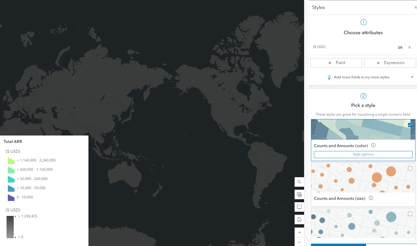

 Here is what the feature layer in one of the webmaps looks now:
And here is the data table in the original feature layer, showing that the data did infact change and so did the necessary field names:
Thank you for your help!! Much appreciated!!

EarlMedina
Did you view the layer's data? It sounds like the Shape values may be missing.
maya_fromstein
Hm, that's so odd that they are missing but you're right. Is there a reason the shape values wouldn't be saved in the geojson? I exported it from the feature layer's page (before I messed it up and there still were shape values) Is there anything I need to do or can do to add them back?
EarlMedina
Ah, so you are appending from a geojson file then? My guess is there may be an issue parsing the geometry data. Is the source data only available in geojson?
