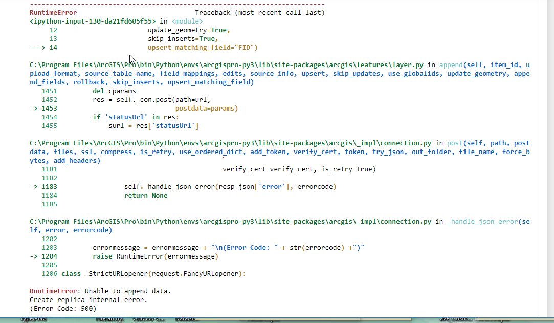

Hi everyone,
I've encountered an issue with my python script:
The script uses an excel file to update attributes of map objects in feature layers on Esri Online.
It gives an error if the excel has multi sheets. (I believe it has something to do with the combination of column headers and the number of sheets.)
Error Msg:
Unable to append data.
Create replica internal error.

VictorZhou1
Update:
In case anyone have this problem as well.
This is part of a bug:
#BUG-000135035
Workaround:
"Cutting the data to be into smaller parts (depending on the data) allow the smaller parts to be successfully appended to the targeted layer."
