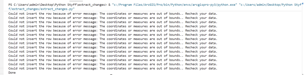

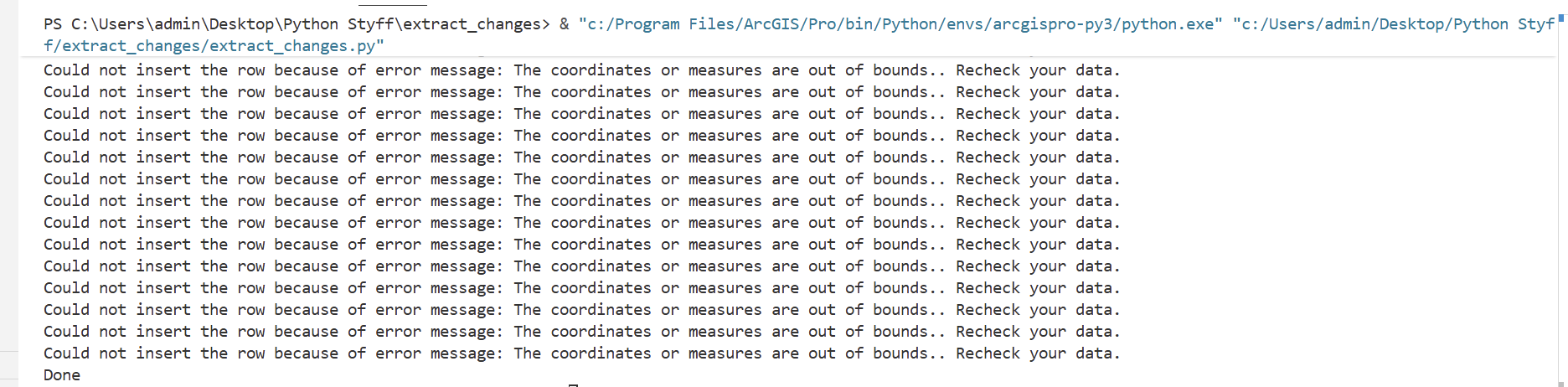

Hello all, I am trying to run a script that will extract the deleted features from a hosted feature layer on ArcGIS Online and ultimately publish them into a new feature class OR feature layer. However any time I run the spatial.to_featureclass() or spatial.to_featurelayer(), I receive the same error stating, "Could not insert the row because of error message: The coordinates or measures are out of bounds.. Recheck your data."

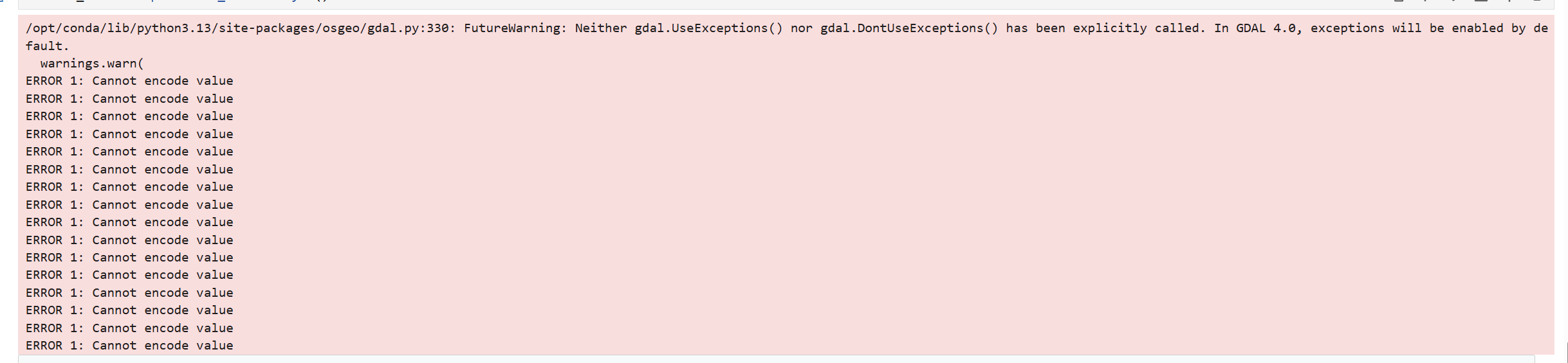

As far as I'm aware there are no additional data transformations that occur on the layer and I am not running any custom or other projections on ArcGIS Online. I am mostly working in VS Code. When I run the same script in Notebooks (with appropriate modifications to work in AGOL Notebooks), I just receive the error "Error 1: Cannot Encode Value". I am running the newest version of the API for Python and newest version of Runtime in Notebooks.
Below is my script and screenshots of the errors I am seeing. Anyone run into this before?

Error in VS Code:

Error in Notebooks

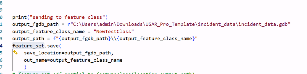

I haven't had a chance to test a similar workflow, but perhaps a different option for creating the feature class might work. The FeatureSet has a save() method you could try.
    feature_set.save(
        save_location=output_fgdb_path,
        out_name=output_feature_class_name
All the best,
Glen
~ learn.finaldraftmapping.com

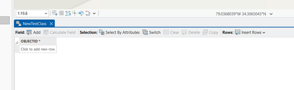

AFackler_NAPSG
Hi Glen,
Looks like that created a File Geodatabase Table that is still completely empty
