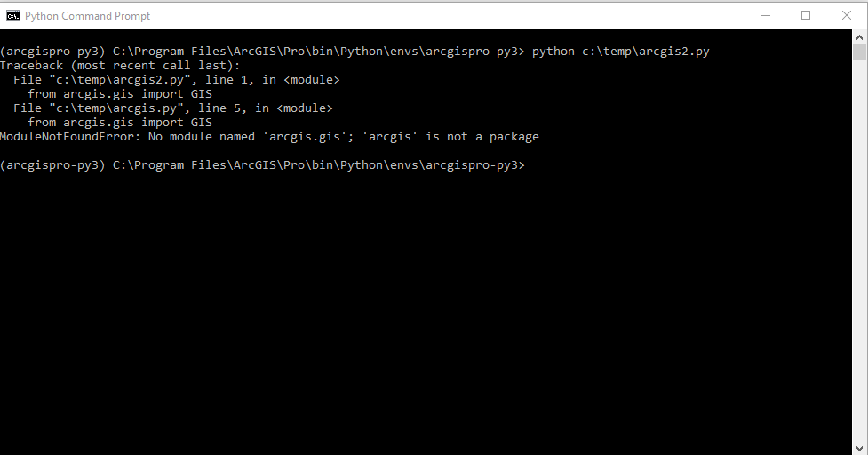

ViktoriaMagnis
Hi
I am having a similar issue. I can run the script fine in the python window in ArcPro but I when I try to run it in the Python Command Prompt I get the "ModuleNotFoundError: No Module named 'arcgis.gis'; arcgis is not a package" .
Thanks
Vicki  Magnis

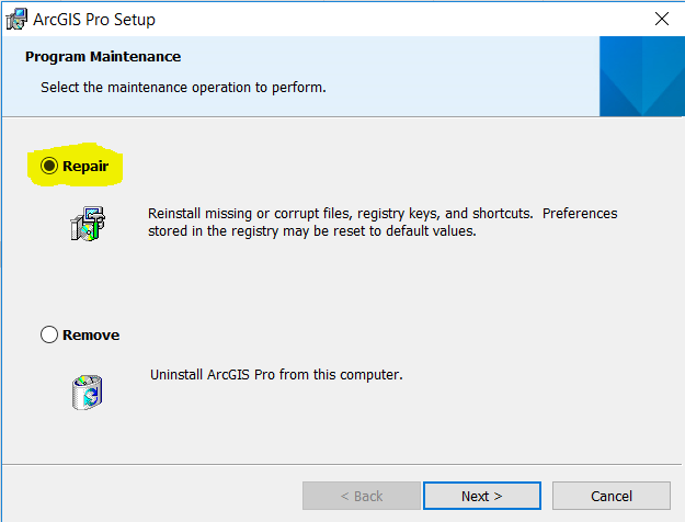

RobertKnapik
Hi,
In my case, the ArcGIS Pro installation repair helped
Robert
