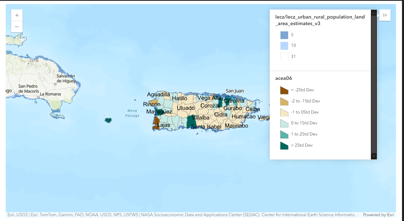

I'm having the issues with modifying the legend content. Especially the layer's title and the first title labels for instance: I want to change 5 to 0 - 5m, and the layer's title acea06 to another meaningful string.
I couldn't find any documentation on modifying the legend properties but only enable it on/off.

Thanks, I tried with the renderers for each layer but it seems the imagery layer is not changed anything.
But when I list the layers there are still 2 layers.

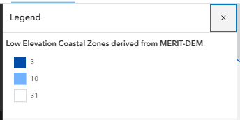

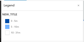

Before...
After...
