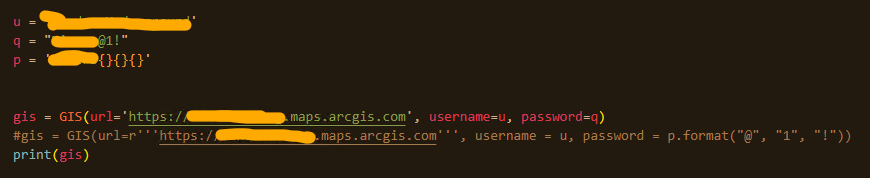

I've tried multiple things to make it work including urllib.parse.qoute, p.format, and some others, but can't get anything to work so far. Is there a solution out there I could try or is this an issue with the API? "At" symbols work fine with other user passwords, just not when there is a number following it. Has anyone else run into this issue and resolved it?

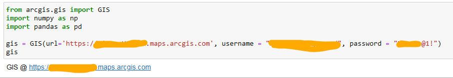

ClaytonBurns2_0-1692021388531.pngClaytonBurns2_0-1692021388531.pngClaytonBurns2_1-1692021416984.pngClaytonBurns2_1-1692021416984.png
Works just fine in AGO Notebook:
