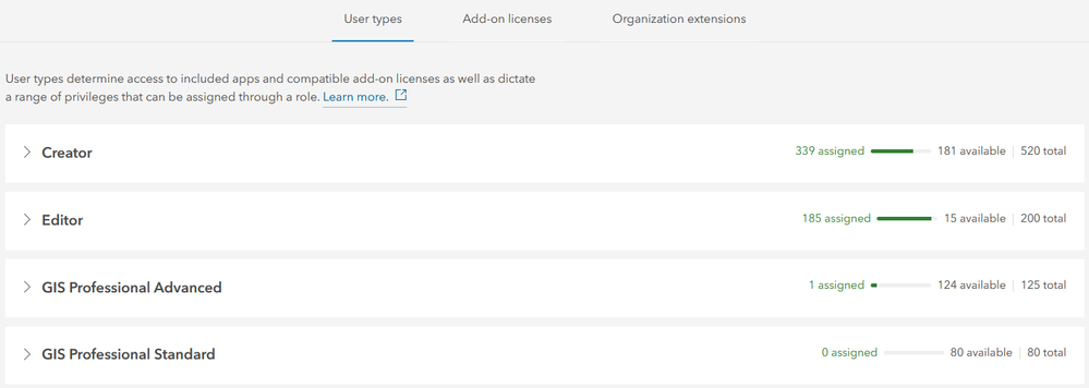

With the switch to user types like 'GISProfessionalBasicUT' and 'GISProfessionalStdUT', this entitlement is not available from the license.  Sure it becomes implicit that the user does have access to a pro license, but how would I access the metadata that is available for Creators with an add-on license.  I still want to be able to log when software was last used, etc.

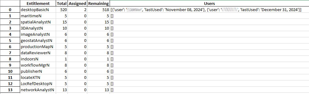

Thank you for this suggestion.  The dataframe returned only shows entitlements for 'desktopBasicN' which are the add-on licenses for Creator user types.  This is the data I can already get using the methodology above.  Missing from the dataframe are entries for GIS Professional Advanced and GIS Professional Standard.  As far as I can see, this method has the exact same limitation as my original approach.  This is on Enterprise v11.1   Is this a bug or known limitation or am I doing something wrong?
The complete dataframe returned:
The user licenses available:
