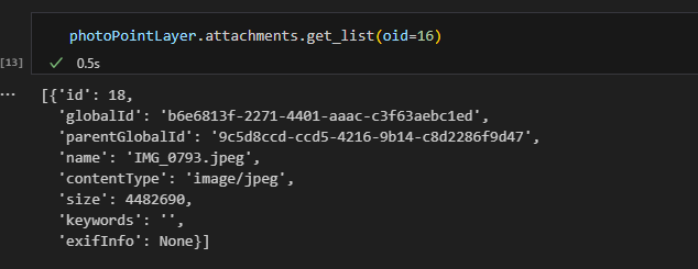

layer.attachments.get_list() not returning EXIF data
1632
03-27-2025 01:50 PM
SFM_TravisBott
tl;dr: the layer.attachments.get_list() returns 'none' for EXIF metadata for a given attachment with the metadata is definitely there.

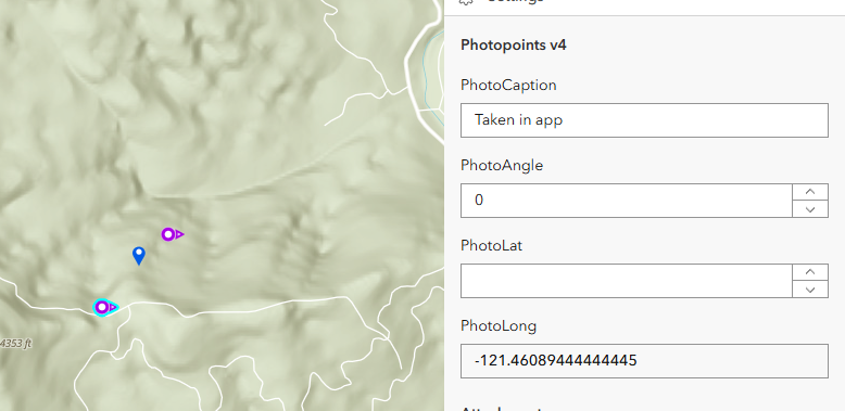

The same record, pulling the latitude via an Arcade form calculation:
What gives?
Premise: I have a feature service with photo points, whose orientation I'd like to be reflected in our maps. As such, there are fields to store orientation angle, as well as latitude and longitude in the photo. These points are captured both in Survey123 and Field Maps, depending on the situation. Pulling EXIF data is simple in S123 and relatively simply when editing in a form in a web app. However, capturing the EXIF data for photos collected in Field Maps has been challenging.
Form calculations in Field Maps do not work, as the photo is not actually part of the service yet. As such, my idea is to run a script and update them post-facto. However, the attachments call seems to ignore metadata, which makes the workaround not so good.

My understanding is the "ExifInfo" field is only used by Survey123 to make grabbing EXIF data faster. You'll have to do this the old-fashioned way: call download, then open the file with a library that can read the EXIF data. I'm pretty sure Pillow is a standard module with Pro so you can do something like this to get the data.
SFM_TravisBott
@DavidSolari Thanks for the comment. This is another unfortunate episode of Esri's platform being so disjointed...somethings work great in some workflows but are darn near impossible in others.
As per this workaround, it's certainly a workaround but good lord is that cumbersome. I've done some tooling around with Pillow and have managed to get what I need out of a given image....but the idea of needing to pull down all of the images that need their data updated is such a pain. I'd rather not be in the business of needing to download hundreds of images just to get data that's immediately extractable if using Survey123.
