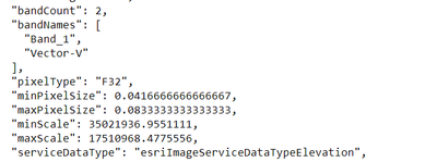

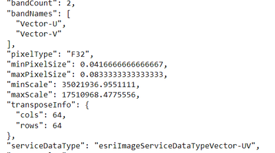

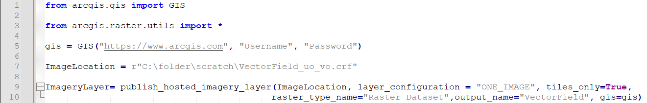

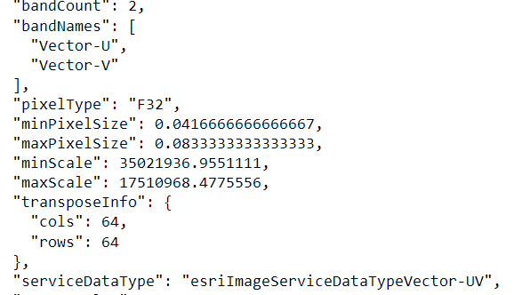

I'm trying to publish an hosted image layer of a multidimensional Cloud Raster Format (CRF) dataset that is data type U-V with ArcGIS for Python 2.2.0.1. I used the publish_hosted_imagery_layer function, but unfortunately it is published as esriImageServiceDataTypeElevation instead of the right esriImageServiceDataTypeVector-UV as it happens by doing everything manually in ArcGIS Online.
Is it a bug? or am I wrong something?
I noticed that the first band is misread.
Instead of
I thank anyone who wants to help me solve this problem.
