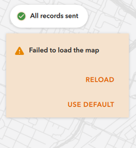

When I add the webmap to a QuickCapture project, and open the project in the QuickCapture app. I get this error:

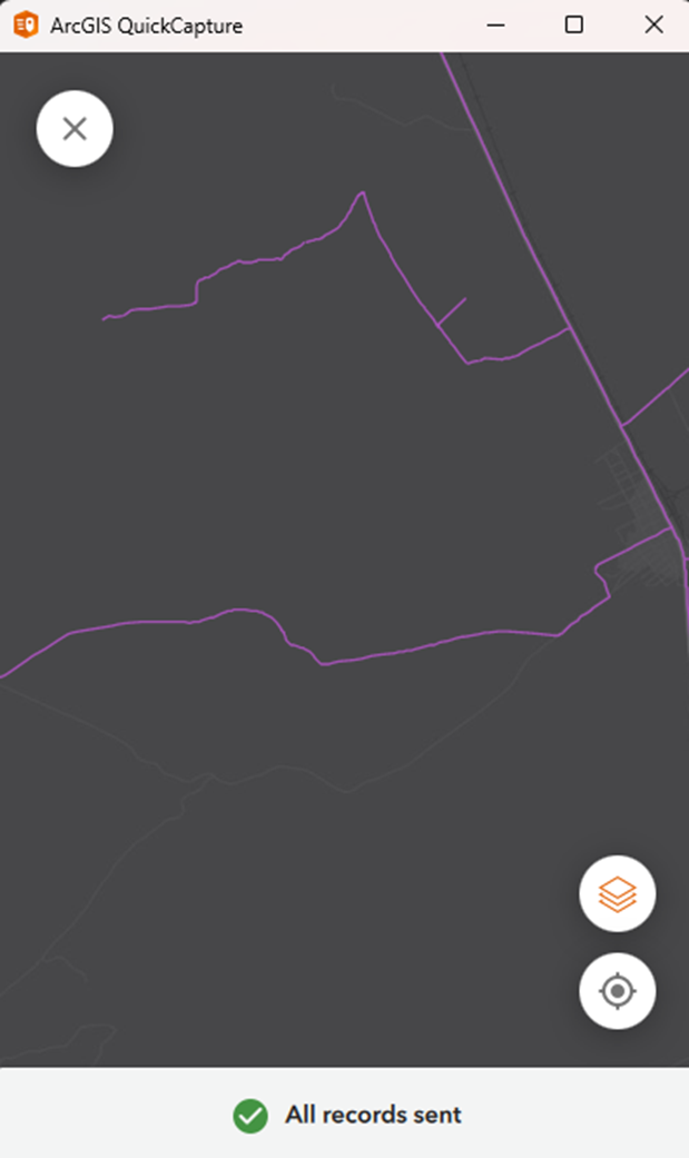

If I open the webmap in the Map Viewer and simply change the extent and save the webmap, the webmap loads in the QuickCapture app just fine:

How can I programmatically “bump” the webmap so it loads in QuickCapture?

UPDATE: I've managed to successfully added the webmap as the QuickCapture project webmap by essentially rebuilding the QC configuration as a dictionary.
HOWEVER: The map does not display the operational layers in QuickCapture that I have added to the webmap in code. I still have to bump-and-save in order for the operational layers to be visible.. Note that the rudimentary layer list in QuickCapture correctly lists the operational layers, they are just not visible in the map.
