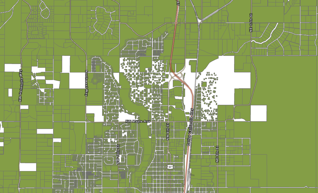

I am trying to use the GIS library to extract parcel data for my City from our County's data. I'm using a spatial filter, but for some reason I am not getting all the data returned. There are random holes in my data. We are interested in about 15% of the records, so I'd rather not have to extract all the data to get what we need.

My guess is you are hitting the max record limit as I don't see logic to page through results. The good news is that getting all records should be relatively simple now. In more recent versions of the API, the query method has a "return_all_records" param you can set to True and the method will automatically keep calling the service until all records that satisfy the where clause are found.
LRoberts_RDM
Hey @EarlMedina Thanks for the reply. I tried adding that parameter into my query, but it didn't seem to help. The service I'm querying is a little funk in that it seems to be built with a join between a layer and a table, and I'm wondering if that's hosing it somehow.
