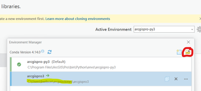

It only matters what conda thinks. If you want to work from inside ArcGIS Pro then go into Projects and open Package Manager, next to "Active Environment" click on the Gear icon. This is the "Environment Manager".  You can put your conda environments anywhere convenient for you. For me when I did a "clone" of the default environment, Pro suggested "C:\Users\bwilson\AppData\Local\ESRI\conda\envs\" but you can choose anywhere. Like I just made one in "arcproclones". Also note the folder I circled in red, you can also add existing folders by clicking there.
See also https://pro.arcgis.com/en/pro-app/latest/arcpy/get-started/what-is-conda.htm
