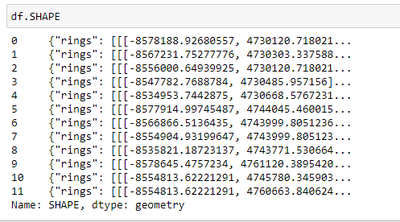

Hi all, this is a re-upload of a previously asked question that I could have worded better. My issue is that when I use the FeatureLayer.edit_features(updates=FeatureSet) method, it is overwriting my geometries. I have done this with several layers now, and it seems to be an issue exclusively with polygons.
Here is my script, broken up with images of my outputs:
polygon_layer_get = gis.content.get("8c1e457fea0341aeb9c29cdf3a1dd64c") # dummy shapefile I made for testing
polygon_layer = polygon_layer_get.layers[0]
df = polygon_layer.query().sdf
For now, notice that the geometry is intact.

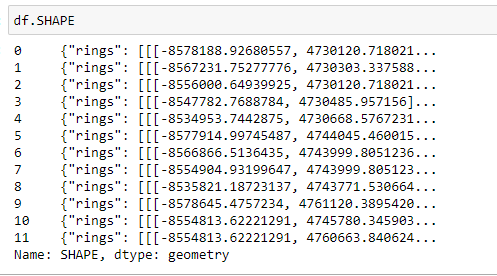

If we look at the SEDF, the SHAPE is still intact.

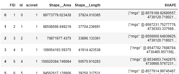

# sedf to feature set
polygon_fs = polygon_sedf.spatial.to_featureset()

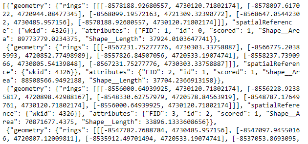

If we look at the FS, we can see the geometry field is still intact.

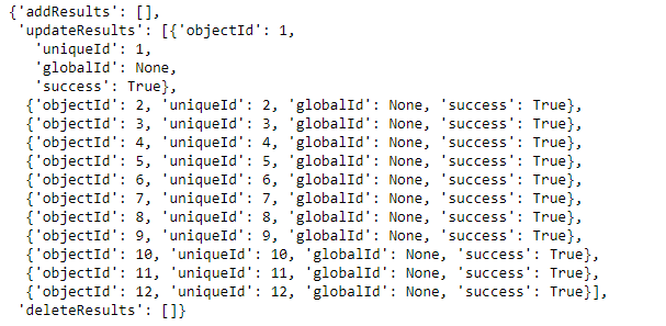

polygon_layer.edit_features(updates=polygon_fs)

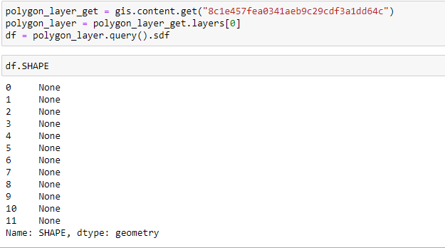

And finally, we edit the features with no issues. But now, if I re-run the first part to load in the polygon data:
All the SHAPEs are None, and looking in AGOL confirms these are now empty records.

I'm not totally convinced GeoPandas is to blame here, because printing "polygon_fs" (the feature set that was created from the dataframe) still has the spatial data. Now that I think about it, I think my issue might be because the feature set is storing the geometry as "geometry" instead of "SHAPE".
However, .edit_features() doesn't have any field mapping unfortunately. I am trying to loop through the feature set (since it is basically a list of dictionaries), but there are some complications. I'll keep chugging away at this route until someone smarter than me suggests something else.
