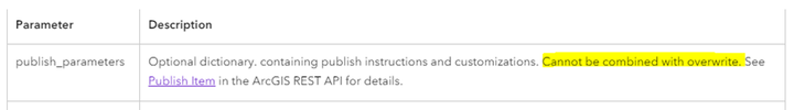

JamieWhite
Hi Scott,
Thank you for posting this solution, and I know it is now three years later, but this no longer works per the documentation. Per the Developers Page you cannot combine a publish parameters with an overwrite
Do you have any other thoughts on how to set the Time Zone for your service you are trying to overwrite.
