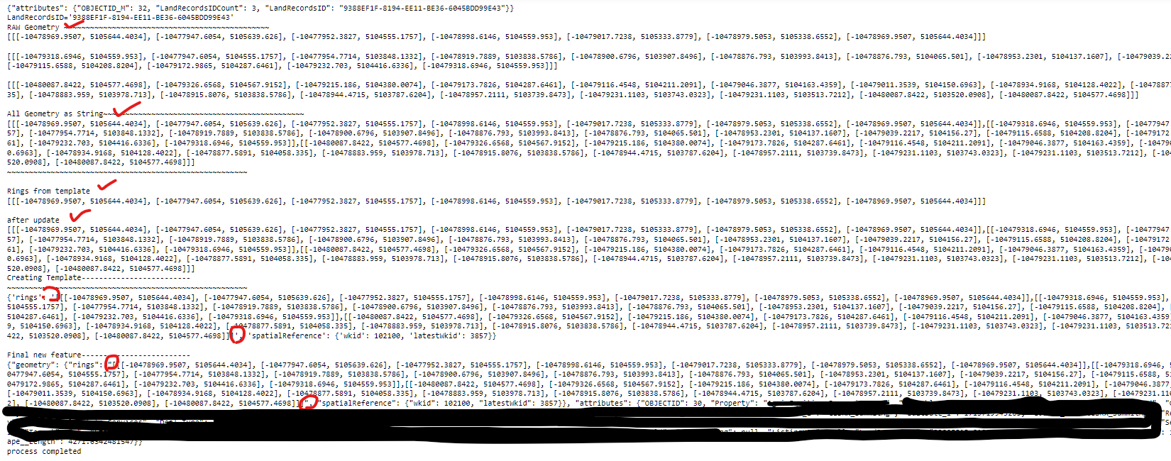

Hello,
I am trying to create a multi polygons feature into a hosted feature layer and I am stuck! I am creating the array of rings on the fly and trying to replay the array of rings from my geometry template. When I print the information, everything looks good, but when I try to create a the feature, my "array" of rings is really a "string" of rings.
below is the code and the issue I am facing
Any help would be much appreciated
Thanks!

Clubdebambos
MVP Regular Contributor
Hi @DominicRobergeIADOT
You are converting the geometry to string.
strPoly = strPoly+str(f.geometry['rings'])[1:-1]+','
when you need to keep it as the nested lists and manipulate the lists instead to create your new geometry..

DominicRobergeIADOT
I had been looking at this issue for too long 🙂
got it
geoArray.append(f.geometry['rings'][0])
Thanks!
