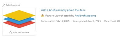

Hi @DonMorrison1
Seems quite odd alright. Just out of curiosity, does it fail with the Item object update_thumbnail() method too. Docs here.
Edit: I tested and it failed with item.update() but was successful with item.update_thumbnail()
Download http://maps.fieldmuseum.org/apps/ROWHWG/icons/FeatureLayer.png succeeded
Upload http://maps.fieldmuseum.org/apps/ROWHWG/icons/FeatureLayer.png to 50261cda83954b8595d3c3427c0c5cb8 as thumbnail succeeded
Download https://rightofway.erc.uic.edu/wp-content/uploads/FeatureLayer_600_400.png succeeded
Upload https://rightofway.erc.uic.edu/wp-content/uploads/FeatureLayer_600_400.png to 50261cda83954b8595d3c3427c0c5cb8 as thumbnail succeeded
Download https://rightofway.erc.uic.edu/wp-content/uploads/FeatureLayer.png succeeded
Upload https://rightofway.erc.uic.edu/wp-content/uploads/FeatureLayer.png to 50261cda83954b8595d3c3427c0c5cb8 as thumbnail succeeded
