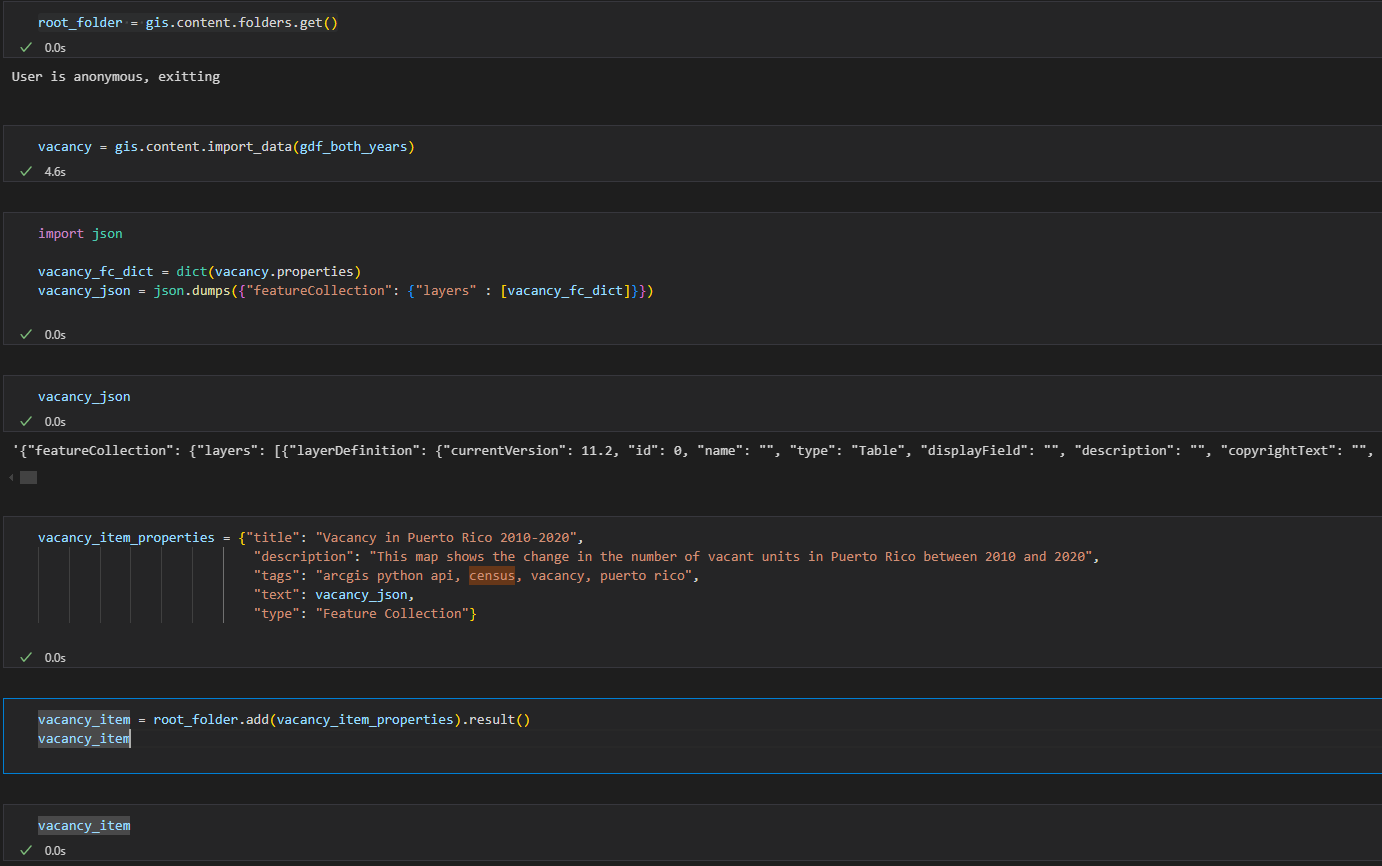

Hi All,
I'm trying to convert my geodataframe to a feature layer so I can overlay it with other layers from AGOL.
I've been researching for a way to do it; the best way is hosted feature layer. When I publish to my content it only has a table view but I want it has polygons as well.
I was following the documentation from ESRI.

HieuTran12
Thanks for your reply. I tried with that solution as well, but this error persists!
AttributeError: `np.NaN` was removed in the NumPy 2.0 release. Use `np.nan` instead.
I tried to reinstall numpy but still no luck. Is there any way to overlay data from gdf to an imagery layer from living atlas?
