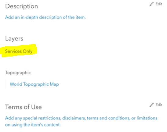

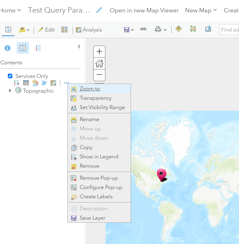

ngrid_ShelbyZ
Mehdi,
Thank you, this is the solution Im looking for. I'm wondering what format it creates? It seems to be a different format than a normal feature service. Notice how you cant navigate to a description of the service, and the dropdown list of the layer is different. Do you know if this is different that a hosted feature service?
MehdiPira1
@ngrid_ShelbyZ ,
Glad that was helpful.

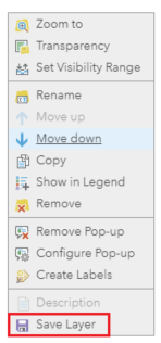

This is a temporary feature layer which still does not exist in the Content.
To make it permanent, you need to Save it as layer and create a new item.
