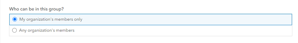

Even if I use the update function to update the membershipAccess to None it does not take? What settings can I use to perform this action using the ArcGIS for Python API, or is it simply a bug?
from arcgis.gis import GIS
agol = GIS("home")
group = agol.groups.get("GROUP_ID")
group.update(
    membership_access = None # typo fixed from acess
If I set manually to Any organization's members, and the query that property, the property does not exist, but it does exist when org or collaboration is set.

Also, some other group settings may restrict your groups to members only. So if you've somehow enabled one of them, it may not give you the option to change the membership access. You can check this setting via the UI - if you can't do it there, you can't do it in python.
Clubdebambos
MVP Regular Contributor
The parameter for membership_access defaults to None, which according to the documentation (rest) should set  to Any organization's members  in the Group settings. This is not the case, the default is org and using the update function and setting to None is not honoured. When I set it manually in the Group settings to Any organization's members, the membershipAccess property disappears from the JSON. The arcgis module version is 2.1.0.2

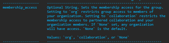

Clubdebambos
It looks like the membership_access parameter is new as of arcgis module version 2.1 as it is not in 2.0. Here is the description from using the python help function. The default, however, is not None, it is org and I cannot seem to set it to None to allow any organization access unless I perform manually.
~ learn.finaldraftmapping.com
