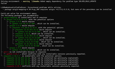

I tried reverting the solver to classic but this failed as well:
I reverted the solver back and attempted to install with no dependencies and still same error:
ZacharyHart
Honored Contributor
UPDATE:
After letting the command prompt sit for >1hour, the following errors are returned:

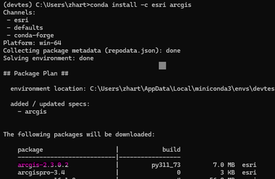

It should be noted that if you simply try to install the arcgis, you will not get the latest version of the API:
What am I missing here!!!???

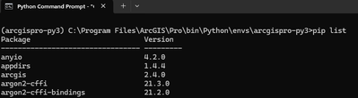

I used the pip method, and that worked without any problems.
pip install arcgis arcgis-mapping

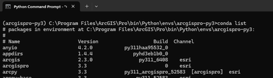

I have all the functionality of 2.4.0, but i can se that the conda environment is not updated to the newest version; while the pip is. I would have guessed they should be the same.
