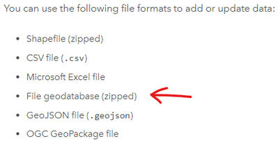

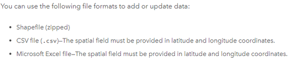

Thanks for the post.  In ArcGIS Online we can export a File geodatabase (zipped) that contains the related data and use this to update a different feature service with the same schema.  However, ArcGIS Enterprise Portal does not support the use of a File geodatabase (zipped) for updates of feature services.
Add and update features from a file (AGOL)
Add and update features from a file (Portal)
We are able to open this File geodatabase in ArcGIS Pro but have no way to update the related service on our Portal with the data and related tables.
