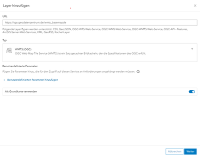

Hi, trying to add a service as basemap to a web map with Python (ArcGIS Pro 3.1) (manually i can do this in Portal 11.1 analogue screenshot  below).
Unfortunately i don't find any example how to do this.
thanks for any help.
