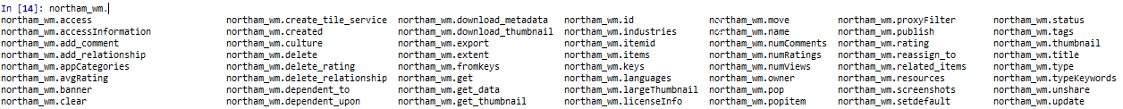

All functions available for use with a webmap object (in this case named "northam_wm") are listed below, but none of them seem to allow adding a feature layer.

Side note: In the image you attached, you are querying the members exposed off the 'Item' object, not the WebMap object. At 1.4.2, you will see methods to list, add, remove layers.
