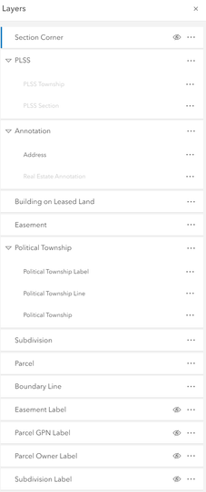

It seems that any layers within a Group Layer are skipped, meaning the user has to check whether the layer is a group layer and then further iterate over the layers within the group to truly retrieve all layers within the web map.
Below is an example.  The grouped layers are expanded to show all the layers within the web map:

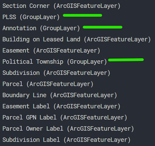

In the code below, the layers within the "PLSS", "Annotation", and "Political Township" group layers are not returned.

None of the layers within the group layers (green line) are returned.  It would be nice if they were returned without having to iterate through each group layer object.
