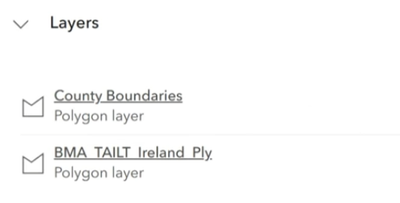

However, if you pay the feature service a visit in ArcGIS Online, this second feature layer is nowhere to be seen. Let's fix that!

Now, when we visit the feature service Overview, Data, or Visualization table, the newly inserted feature layer is present.
