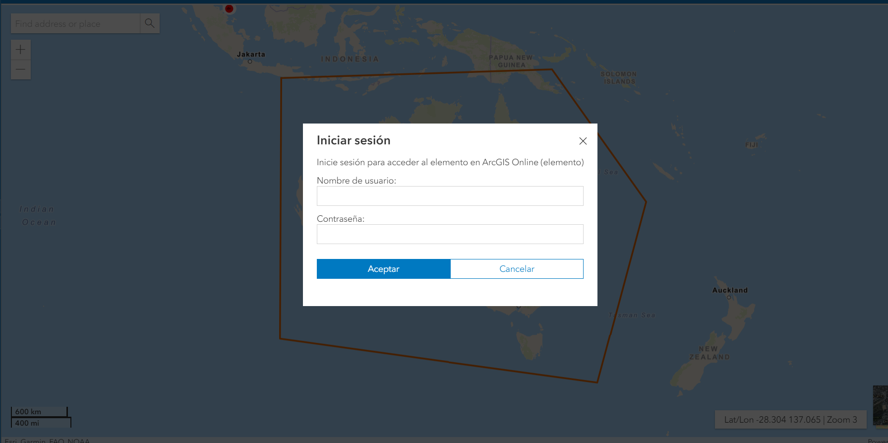

Hello everyone,
I just tried load a customfeatrue layer from my arcgis online account. I did it whitout problems
However every time and open my script there is an esri-identity-form wich ask for user and password (image I added). So, I would like load my personal layers from arcgis online whitout show or view this form, I mean try other way to loading and authentication or just authentication in background process.
Could anyone show me a easy example??
Thanks!!!

For understanding what I am doing:
I use this code for loading a featureLayer from my Arcgis Online Account:
CustomArcgisLayer = new FeatureLayer({
            url: my service url (https://services6.arcgis.com/ ......),
Every time I start my html or application there appear a credential dialog, so, I did this for fill this dialog.
Basically I fill it using javascript
var form_esri_dialog=document.getElementsByClassName("esri-identity-modal esri-identity-modal--open")[0];
if(typeof form_esri_dialog!="undefined"){
            var user= Array.from(document.getElementsByClassName("esri-identity-                form")  [0].querySelectorAll('input[type="text"]'));
              var password=Array.from(document.getElementsByClassName("esri-
              identity- form") [0].querySelectorAll('input[type="password"]'));
               user[0].value="xxxx";
               password[0].value="xxxxx";
               var submit_form= Array.from(document.getElementsByClassName("esri-identity-
               form")[0].querySelectorAll('input[type="submit"]'));
               submit_form[0].click();
I would like not doing this ...I would like do this in a background process or automatically
I will look all the information you gave me,
Very thanks again
