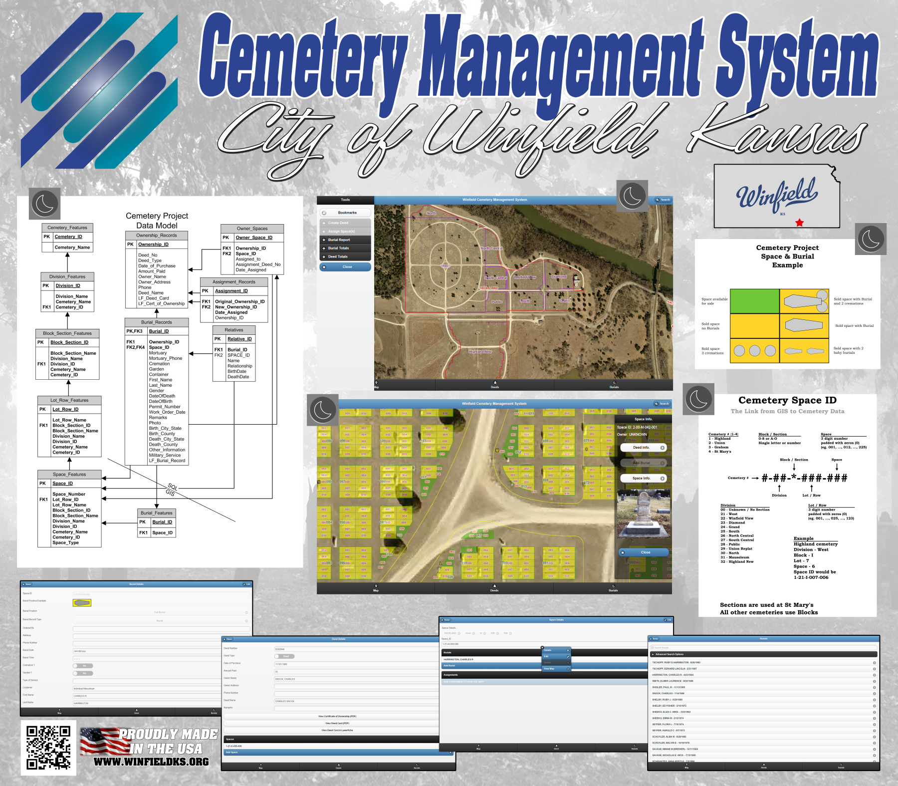

Cemetery Management System
1. Open project in visual studio 2012 or VS Web Express 2012
2. Set database "cemeteryContext" connection string in web.config
3. Set vb.net project settings using visual studio
4. Set javascript settings in Scripts/config.js
5. Add local groups to computer/server running app (Cem_Admins, Cem_Burial_Editors, Cem_Deed_Editors)
6. Add Users to groups
7. Build project
Also, in zip file is Cemetery_Config_Test.mpk that contains sample data to create the ArcGIS services required for the app to run (Publish as feature service and map service)
Demo - Winfield Cemetery Management System
