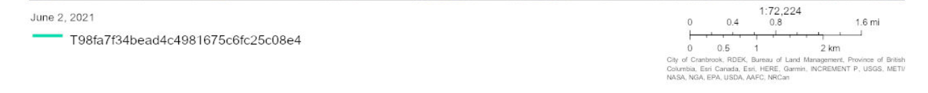

I have two objects left with the print template, one is to centre the legend and the other is to remove the text under the scale, is it possible to do both of those things?
My current template object:
const template = new this.PrintTemplate({
format: 'jpg',
layout: 'a4-landscape',
layoutOptions: {
authorText: '',
copyrightText: '',
customTextElements: [{
'description': '',
'location': ''
titleText: titleText
attributionVisible: false,
showLabelsBoolean: false,
 If it's not possible, that's fine.
Thanks

Hello,
I'm going to assume that you are using either the ArcGIS Online print service or the out of the box print service that comes with ArcGIS Enterprise.
If so, then the print layouts are fixed and cannot be modified. You can change some elements, like the title or the date, etc but not what is included or not (eg the attribute text under the scale bar).
However, if you are referencing a custom print service (only on ArcGIS Enterprise) that has custom print layouts then it may be possible to talk with the custodian of this print service to produce print layouts to your requirements.

AndrewMurdoch1
That's what I was thinking, thanks for your answer.
