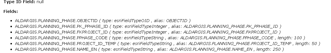

Yes the service rest has the latest aliases like this snapshot

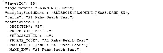

and weirdly I get the identify results(check snapshot) with other names/aliases I don't know where they are coming from
I want to mention that i have only one layer that get the updated aliases in the identify task results, others are not!
