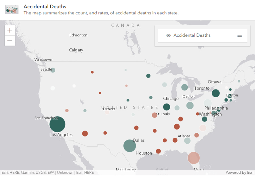

JavaScript Maps SDKとCalciteで作られた Web マップ
<html>
  <head>
    <meta charset="utf-8" />
    <meta
      name="viewport"
      content="initial-scale=1, maximum-scale=1, user-scalable=no"
    <title>Calcite and map components (imperative)</title>
    <script
      src="https://js.arcgis.com/calcite-components/1.9.2/calcite.esm.js"
      type="module"
    ></script>
    <link
      rel="stylesheet"
      href="https://js.arcgis.com/calcite-components/1.9.2/calcite.css"
    <script src="https://js.arcgis.com/4.28/"></script>
    <link
      rel="stylesheet"
      href="https://js.arcgis.com/4.28/esri/themes/light/main.css"
  </head>
  <style>
    html,
    body,
    #viewDiv {
      height: 100%;
      width: 100%;
      padding: 0;
      margin: 0;
  </style>
  <body>
    <calcite-shell>
      <calcite-navigation slot="header">
        <calcite-navigation-logo slot="logo" />
      </calcite-navigation>
      <div id="viewDiv"></div>
    </calcite-shell>
    <script>
      require(["esri/WebMap", "esri/widgets/LayerList", "esri/views/MapView"], (
        WebMap,
        LayerList,
        MapView
        const webMap = new WebMap({
          portalItem: {
        const view = new MapView({
          container: "viewDiv",
          map: webMap,
          zoom: 4,
        view.when(() => {
          const portalItem = view.map.portalItem;
          const navigationLogo = document.querySelector(
            "calcite-navigation-logo"
          navigationLogo.heading = portalItem.title;
          navigationLogo.description = portalItem.snippet;
          navigationLogo.thumbnail = portalItem.thumbnailUrl;
          const layer = view.map.layers.find(
            (layer) => layer.id === "Accidental_Deaths_8938"
          layer.popupTemplate.title = "Accidental Deaths";
          const layerList = new LayerList({
            view,
          view.ui.add(layerList, "top-right");
          layerList.listItemCreatedFunction = (event) => {
            const item = event.item;
            if (item.layer.type !== "group") {
              item.panel = {
                content: "legend",
    </script>
  </body>
</html>

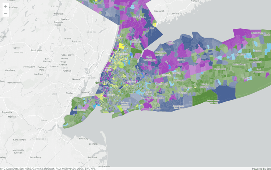

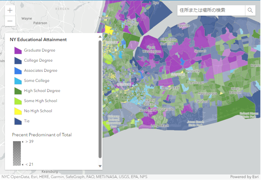

JavaScript Maps SDK コンポーネントと Calcite で作られた Webマップ
<html lang="en" dir="ltr">
  <head>
    <meta
      name="viewport"
    <title>Calcite and map components (declarative)</title>
    <script
      type="module"
    ></script>
    <link
      rel="stylesheet"
    <link
      rel="stylesheet"
    <script
      type="module"
      src="https://js.arcgis.com/map-components/4.28/arcgis-map-components.esm.js"
    ></script>
  </head>
  <style>
    html,
    body,
    arcgis-map {
      padding: 0;
      margin: 0;
      height: 100%;
      width: 100%;
  </style>
  <body>
    <calcite-shell>
      <arcgis-map item-id="e691172598f04ea8881cd2a4adaa45ba" zoom="4">
        <arcgis-layer-list position="top-right" />
      </arcgis-map>
    </calcite-shell>
    <script type="module">
      const mapElement = document.querySelector("arcgis-map");
      const layerListElement = document.querySelector("arcgis-layer-list");
      layerListElement.addEventListener("widgetReady", (event) => {
        const layerList = event.detail.widget;
            item.panel = {
              content: "legend",
      mapElement.addEventListener("viewReady", async (event) => {
        const view = event.detail.view;
    </script>
  </body>
</html>

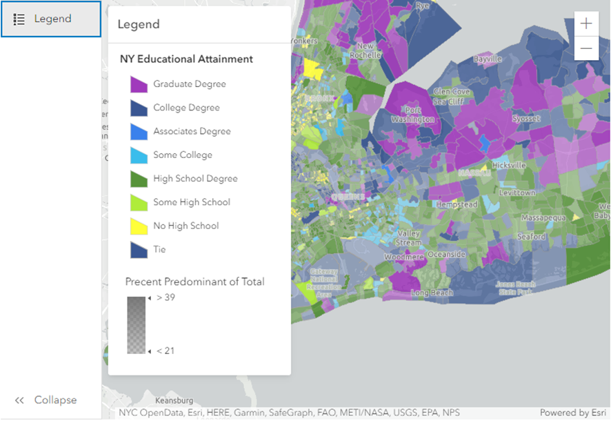

ウィジェットをマップやシーンに簡単に関連付ける
JavaScript Maps SDK コンポーネントは、アプリの可読性とシンプルさをさらに向上させます。例えば、ウィジェットは reference-element(詳細はプロパティ タブを参照)を <arcgis-map/> id に設定することでマップにアクセスできます。これはウィジェットが<arcgis-map/> コンポーネントの外側にある場合に便利です。
地図に関連した凡例
  <head>
    <meta
      name="viewport"
    <script
      type="module"
    ></script>
    <link
      rel="stylesheet"
    <link
      rel="stylesheet"
    <script
      type="module"
    ></script>
  </head>
  <style>
    html,
    body,
    arcgis-map {
      padding: 0;
      margin: 0;
      height: 100%;
      width: 100%;
  </style>
  <body>
    <calcite-shell content-behind>
      <calcite-shell-panel slot="panel-start" display-mode="float">
        <calcite-action-bar slot="action-bar">
          <calcite-action
            data-action-id="legend"
            icon="legend"
            text="Legend"
          ></calcite-action>
        </calcite-action-bar>
        <calcite-panel
          heading="Legend"
          height-scale="l"
          data-panel-id="legend"
          hidden
          <arcgis-legend
            id="legend-container"
            reference-element="#viewDiv"
          ></arcgis-legend>
        </calcite-panel>
      </calcite-shell-panel>
      <arcgis-map item-id="05e015c5f0314db9a487a9b46cb37eca" id="viewDiv" />
    </calcite-shell>
      // Reference the map component
      mapElement.addEventListener("viewReady", ({ detail: { view } }) => {
        view.ui.move("zoom", "top-right");
        view.padding = { left: 49 };
        let activeWidget;
        const handleActionBarClick = ({ target }) => {
          if (target.tagName !== "CALCITE-ACTION") {
            return;
          const nextWidget = target.dataset.actionId;
          if (nextWidget === activeWidget) {
            target.active = false;
              `[data-panel-id=${nextWidget}]`
            ).hidden = true;
            activeWidget = null;
          } else {
            if (activeWidget) {
                `[data-action-id=${activeWidget}]`
              ).active = false;

        let actionBarExpanded = false;
        document.addEventListener("calciteActionBarToggle", (event) => {
          actionBarExpanded = !actionBarExpanded;
          view.padding = {
            left: actionBarExpanded ? 150 : 49,
        document
          .querySelector("calcite-action-bar")
          .addEventListener("click", handleActionBarClick);
    </script>
