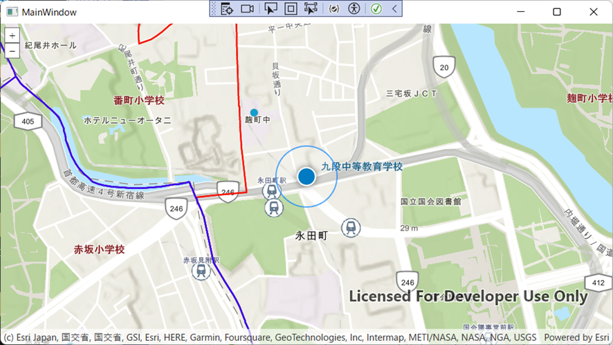

1. After InitializeComponent() in MainWindow.xaml.cs, set up enabling current location display for MapView's LocationDisplay.
MainWindow.xaml.cs
public MainWindow()
InitializeComponent();
// Display current location on the map
MainMapView.LocationDisplay.IsEnabled = true;
MainMapView.LocationDisplay.AutoPanMode = LocationDisplayAutoPanMode.Recenter;

Enable Location Services on Windows
If Location Services are disabled on your Windows
'Settings' → 'Privacy & Security' → 'App permissions' category → 'Location' → 'Location services' in that order, turn on the following items:
- 'Location services' Allow apps to access your location Allow desktop apps to access your location.
2. Try running the app. You should see a blue circle indicating your current location provided by your device's Location Services.
