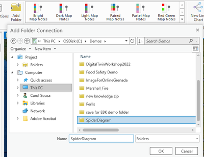

"In ArcGIS PRO or ArcMap you may connect a folder to this the desktop folder so that you access these files."
HOW, man, HOW can I do it????? Help...
CarolSousa
Esri Alum
@RogérioAzevedo after downloading the zip file, if you extract to (for example) C:\Demos\SpiderDiagram, you would then open ArcGIS Pro, go to Insert tab on the ribbon, click Add Folder, then navigate in the Add Folder Connection window to C:\Demos and select SpiderDiagram, then click OK.
Then you can get to the folder from the Catalog pane.
