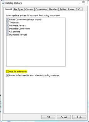

By default, python toolboxes do not display the "pyt" file extension. To display this and other known extensions in ArcCatalog (or the catalog window in ArcMap) check the following:Snap31.png
This dialog is accessible in ArcCatalog by clicking Customize > ArcCatalog Options.  Unchecking the highlighted option will show the following:Snap4.png
