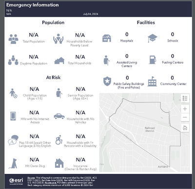

https://www.esri.com/arcgis-blog/products/esri-demographics/developers/esris-2022-updated-demographi...
might be something you have to pay for. I know esri can calculate the population for you
