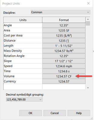

Thank you for responding. For now, I only need Dimension Table, specifically volume. I tried a workaround by converting revit file into Multipatch then I Calculate Geometry to get volume. But there's a slight difference between volume from revit and from ArcGIS Pro calculation. Does revit rounding up the value? Or it is a real different value? Do you have any solution to get the volume attributes from revit?

DA_BIM-GIS
Hello
That difference is due to the setting in Revit that you have. Look at the Project Units setup.
In the example below the setup is set to only display 2 decimals on the volume.
Best regards,
David
