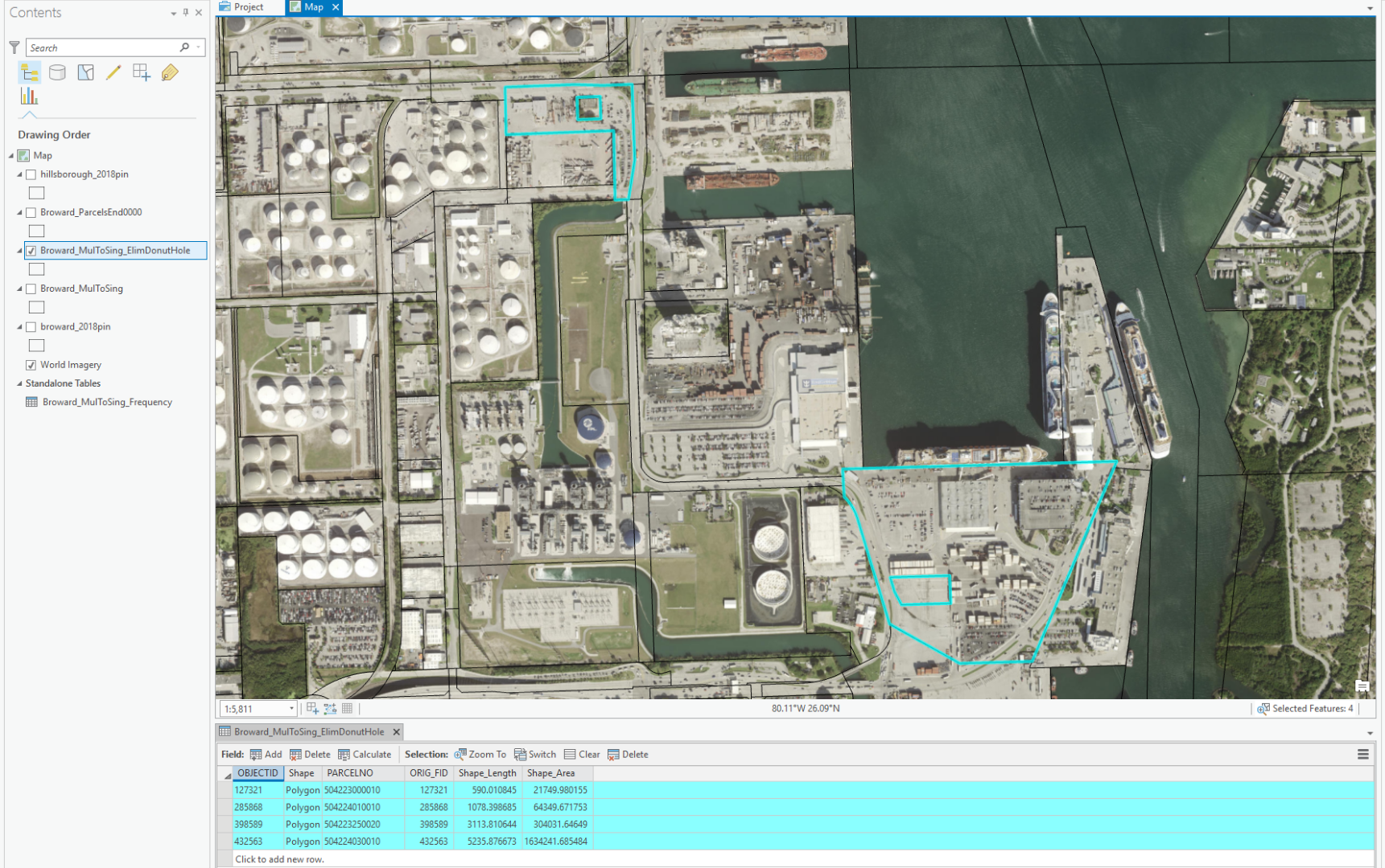

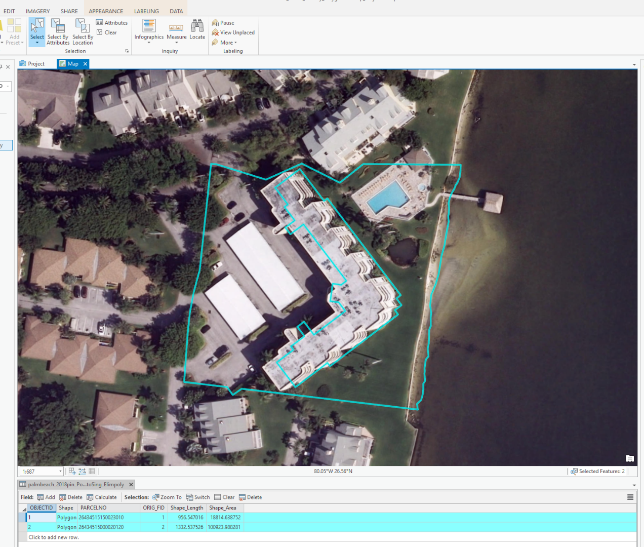

Hello,
I am working with a parcel shapefile of an entire state. I need to remove all of the building polygons falling inside the bigger parcel polygon. These are not donut holes but instead separate polygons.
I can't erase each polygon manually because I am working with the entire state dataset.
What geoprocessing tool should I use?
I have attached an image below:
Thank you!

select by location using 'completely contain'. I think!... been a long time, since I tried this.  same file as target and source
NataliaGutierrez2
Thank you Dan, it worked!

Dan, now that I am trying it out in a bigger dataset that includes all of the parcels from a county this method is not working. It seems as if it did not recognize the polygons completely within another polygon.
Should I do something else instead?

'completely contain' wasn't that the one that worked before??
NataliaGutierrez2
Yes, I was using 'Completely Within' but I was trying it on specific parcels on a separate mxd, but when I tried it on the mxd that contains all of the county parcels it did not work.
It seems as if it does not recognize the parcels that are within another one.

try 'Contains Clementini'
